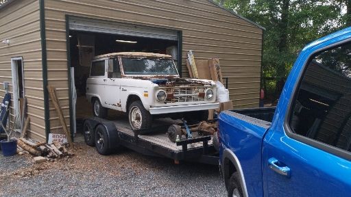

Well it went like this: I sold, then asked for permission/ Is this the right thing to do? Then we went to SuperCel as we have
been doing for years now. We saw Loads of Broncos, old, newer, and so new no one has one yet! Then we bought another project! Everyone meet Patché! This will be the more refined version of Patches! We're very excited to tear into it and have some REALLY cool things planned (that I've never seen done before).
Just a few pics sitting on the trailer and rollin it into the shop.

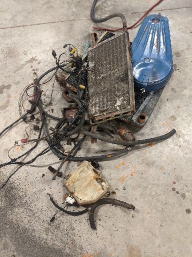

We've ripped out the radiator, ditched the factory AC, got rid of the rusted hood hinges, and got the door hinges loose (on the driver side).
Good progress for an hour or so.

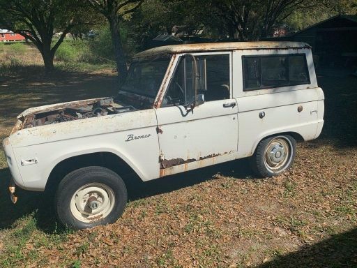

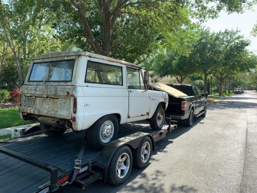

It has a Jacksonville JSO code. The prior owner got it out of Tampa. Its NEVER left FLorida. We think thats pretty cool! It is all original, never touched. straight as an arrow, rear seat delete and radio delete. Its going to be a good one!
