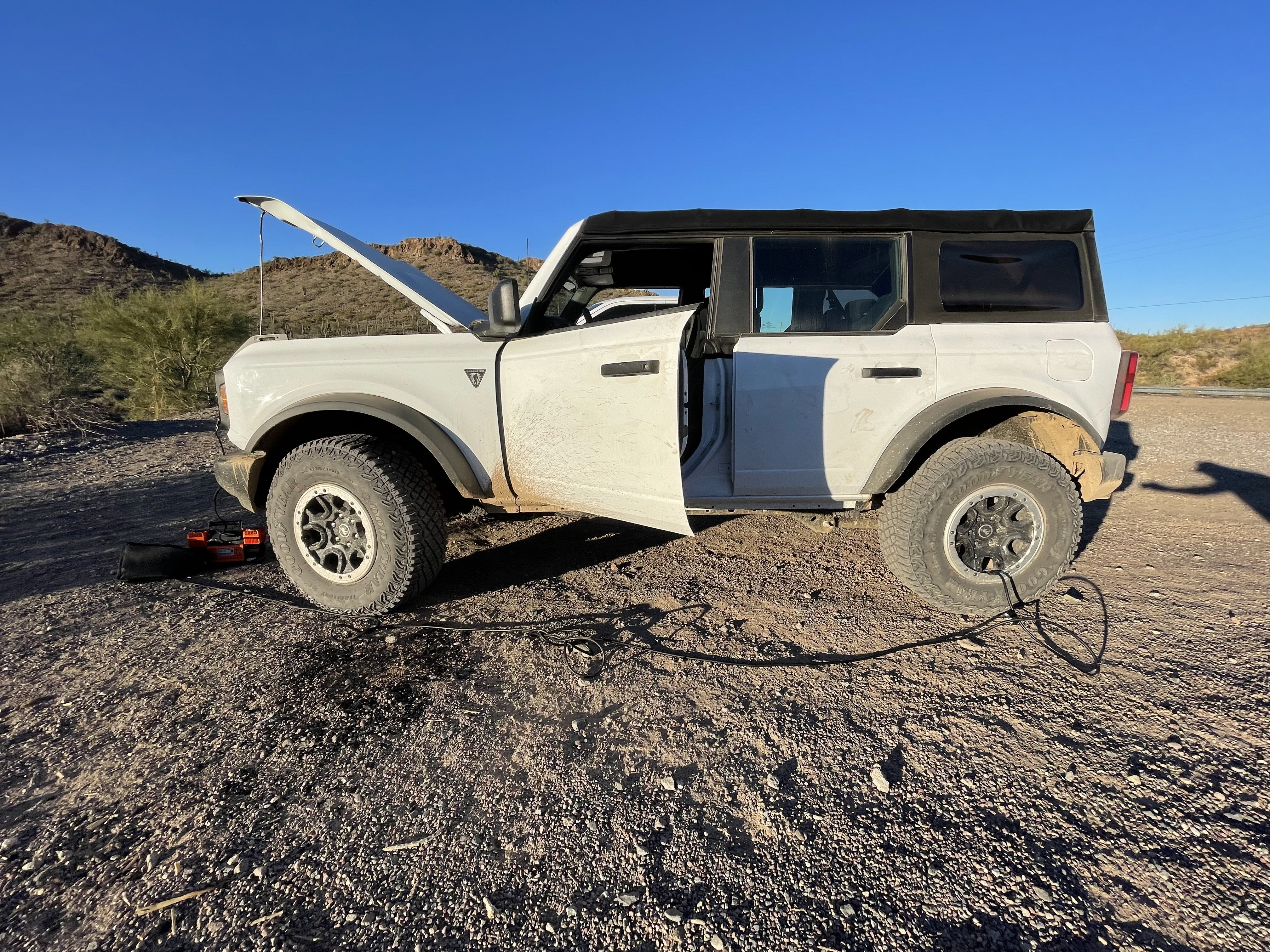

1. Compressor and deflator
So let's start out with the most important component of all of this, which to me, is an air compressor. You do not have to break the bank to get a half-decent one, but I would not recommend getting the harbor freight one or any of the really cheap ones. I borrowed one of those when I had my jeep and it took me about 30 minutes just to fill up my 33's. Especially if you have a sasquatch... you're going to hate airing back up. The goal with a compressor is to make it fast enough to where you'll actually want to get out there and wheel! Unfortunately, the compressor I have is now discontinued from NAPA, however, I have heard great things about this smittybilt one. Or if you've got the cash, an ARB will last a lifetime. Once I've found a new career that will be on my list, but for now the one I've got works great!
One cool thing about the smittybilt compressor is it is right at the limit of how much your valve stem can handle, which is right around 5 CFM. So a bigger/heavier compressor won't actually air you up faster unless you get a multi-tire inflation system. With that one, you'll be aired up in about 10-15 minutes and back on the road! Also as a pro tip: Snag one of these quick-connect chucks. The last thing you want to do after wheeling all day is mess around with manually screwing on each Schrader valve.
Now deflating your tires is a little bit less exciting, but personally, I've been using this one: There are more "automatic" options where you can basically just screw the deflators on, and they bring you to a preset PSI. But I've heard those have some troubles and are a bit finicky. This one lets you take the valve core out so it deflates super quickly, and I just watch the gauge cluster until it gets to where I want, then run over and close the valve.
And now the data I promised! I decided I hated myself and that I would air back up even though I was still about 2 rough miles away from the highway, just to give you guys a direct comparison between being aired down and aired up:
https://vm.tiktok.com/ZTdGUkTG8/?k=1
It showcases it best when comparing the two very ends, you can hear tons of rattles and my stuff jostling around a lot more when fully aired up. But honestly, this video doesn't even do it justice... I just won't even go down a rough dirt road without airing down, especially with how high they want your stock tire pressure to be! Airing down to 17-20ish PSI totally changes the game, and really showcases what this bad boy is capable of. So anyone on the fence on if it's worth it... or if you think the Bronco rides rough, airing down is a total game-changer. My #1 "Mod".

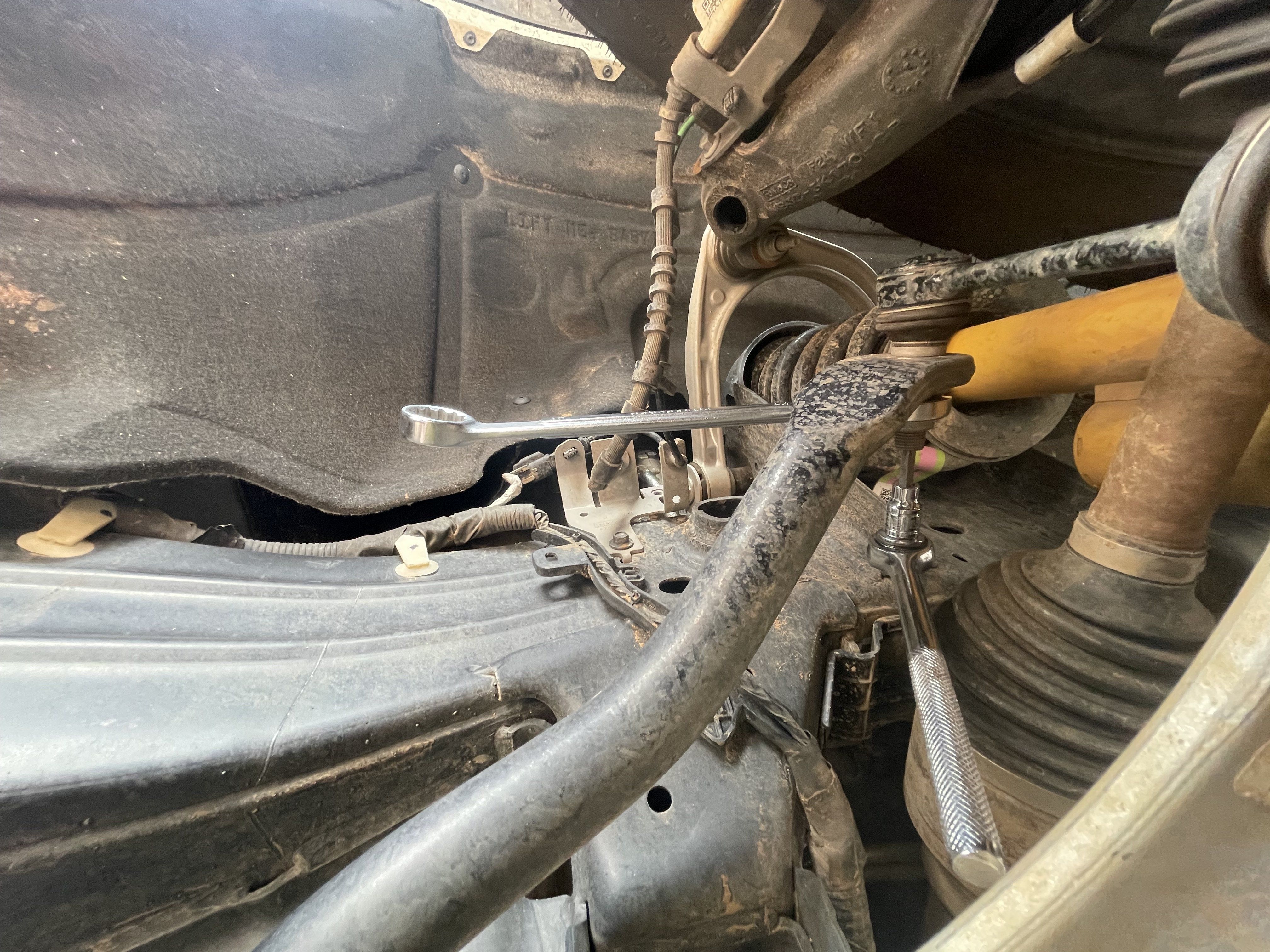

First of all, big benefit: It's basically impossible to manually disconnect the swaybar without this product. The only way to do so would be to remove the link entirely, you can't just pull out the bottom bolt and hang it up, it will not disconnect without the top bolt being removed. (Which is SUPER annoying to do. Pictured here is how I did it when doing the install, you have to hold the ball joint in place with a Torx and use a wrench to remove it.)
This is something that isn't horrible to do once, but I would not want to do it every single time you offroad.

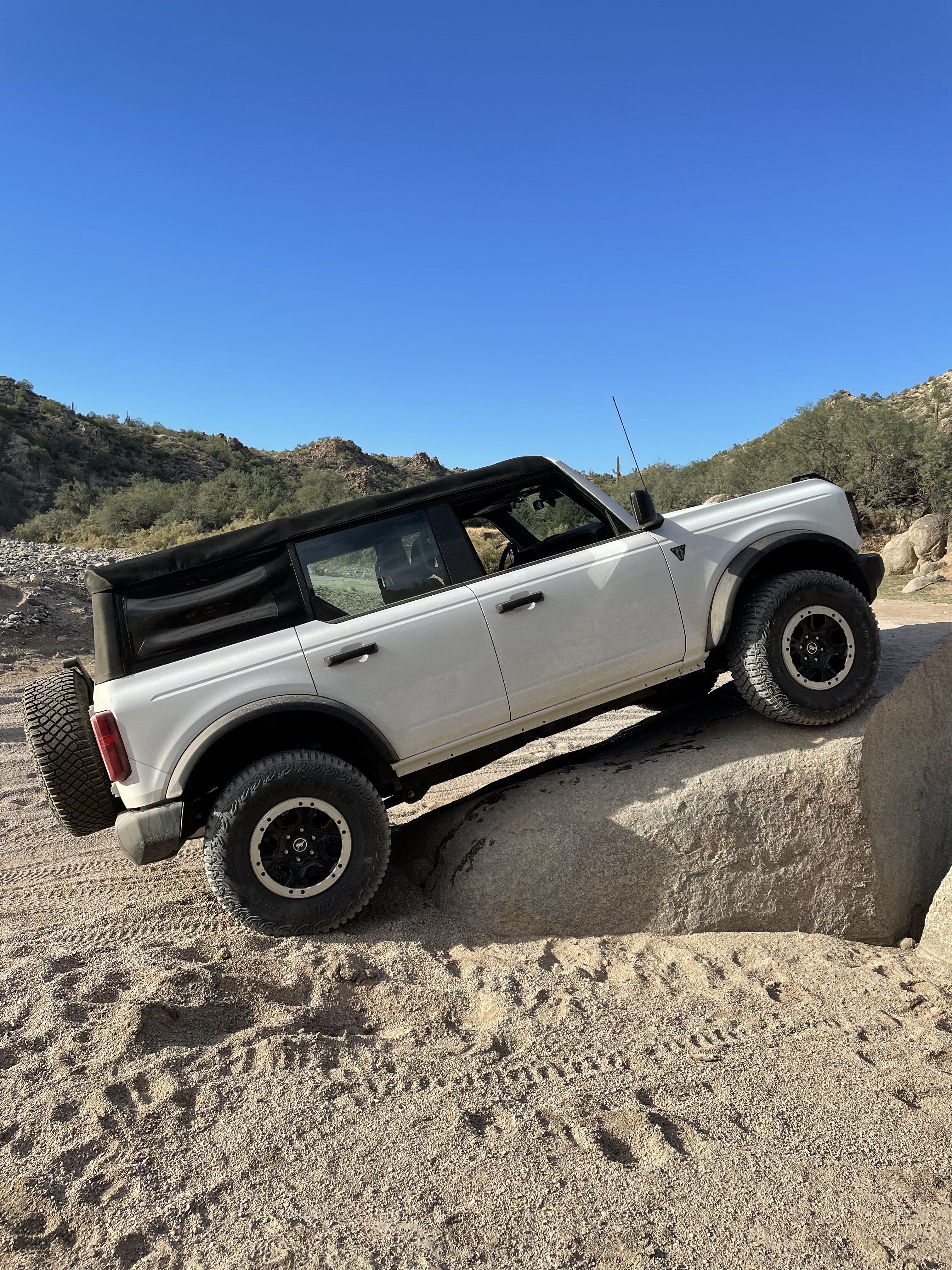

The downside of this product: It's definitely a bit annoying to disconnect and reconnect. You really need to find the right spot for the suspension to be relaxed enough to let it come off, usually this means you're going to be stacking a rock or trying to find a dip in the parking lot. It takes about 5 minutes total for me to get both off at the beginning of the day, and then about 10 minutes to get them back on. This is however something you get better at with time, and the performance gains are pretty significant. But I wanted to quantify what the gains are exactly, so I headed to what I'm now calling "RTI Rock".

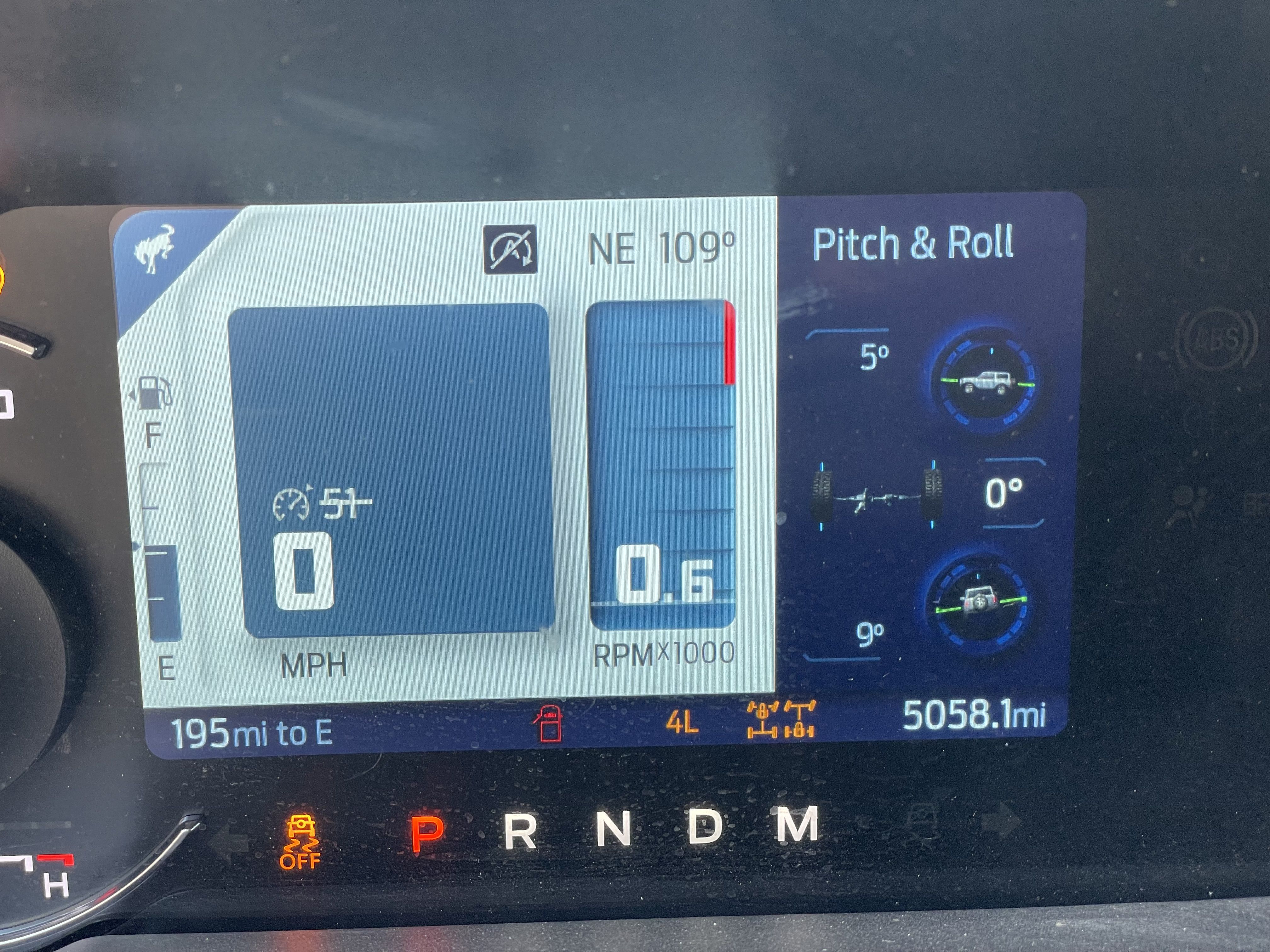

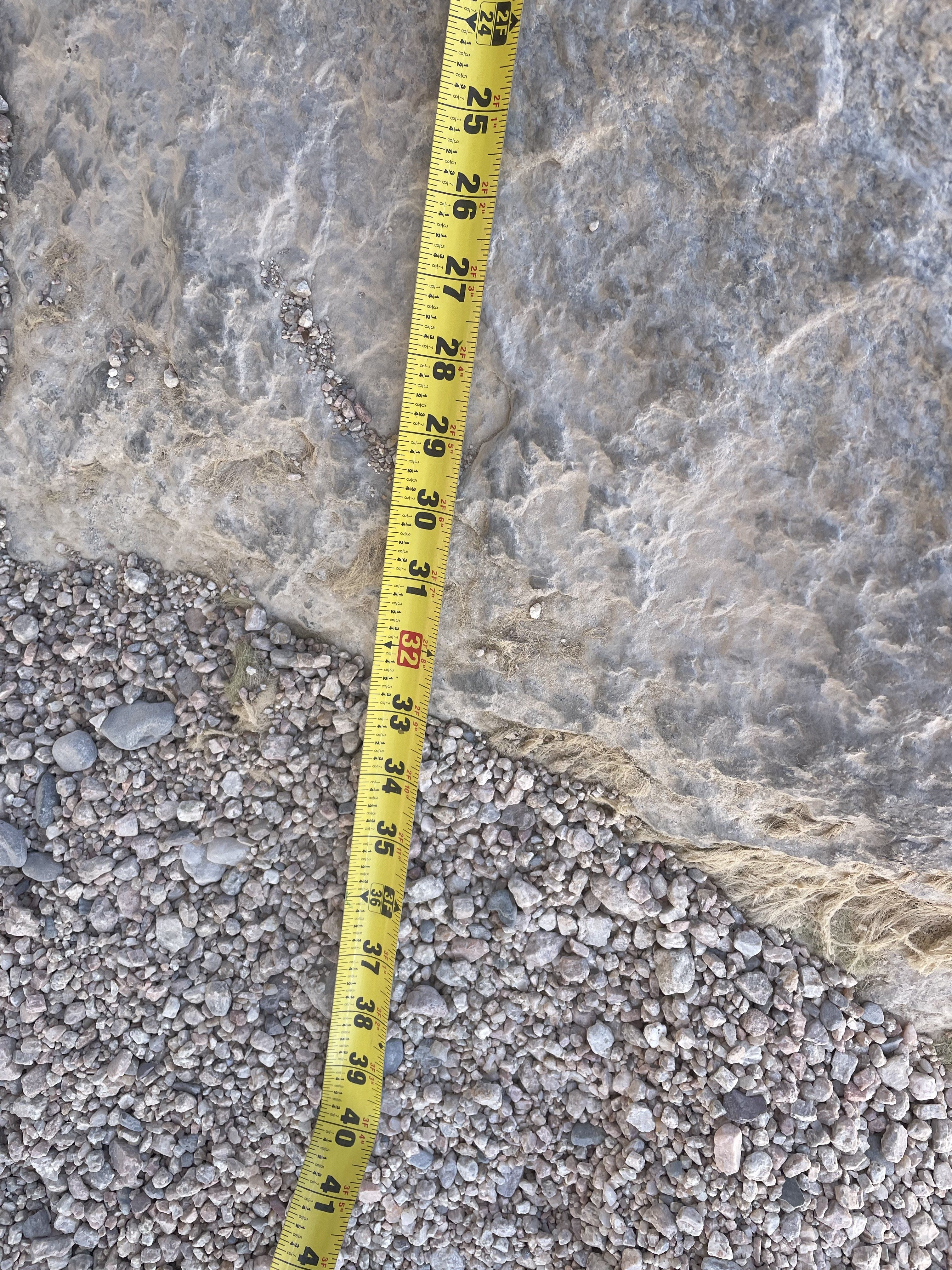

But instead of climbing it with both front tires, I climbed with just the front passenger, and then gathered some data from there. So this was a bit of a feel thing, but I started out with the sway bar disconnected. I climbed as far up the rock as I could go with the rear passenger tire still having solid contact with the ground. (This is pretty easy to feel.) What resulted is that I was able to climb up the rock about 32'' from the back of the tire to the sand.

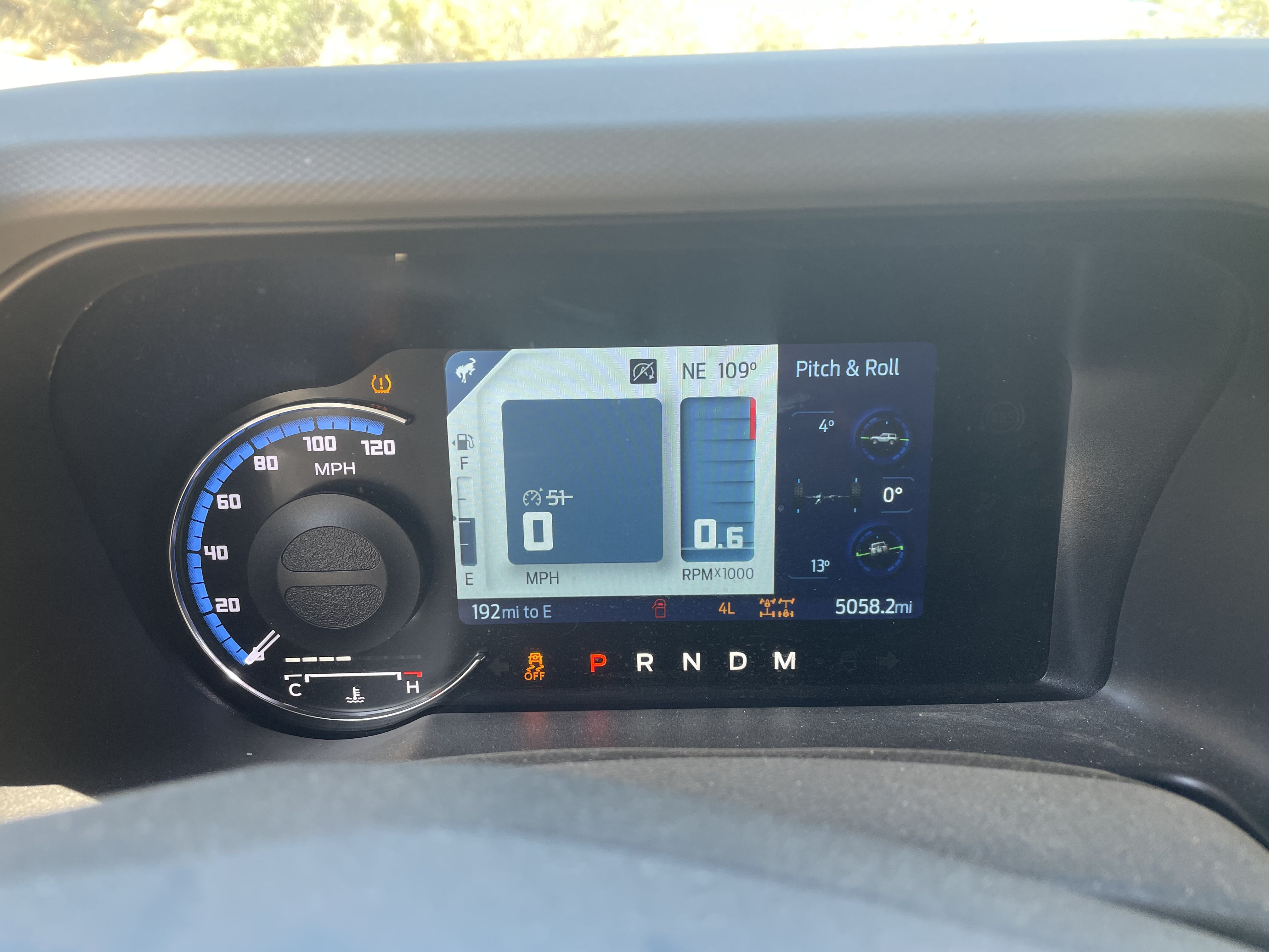

And with that climb, I also got the cabin statistics showing 9 degrees of body roll, with 5 degrees of incline.

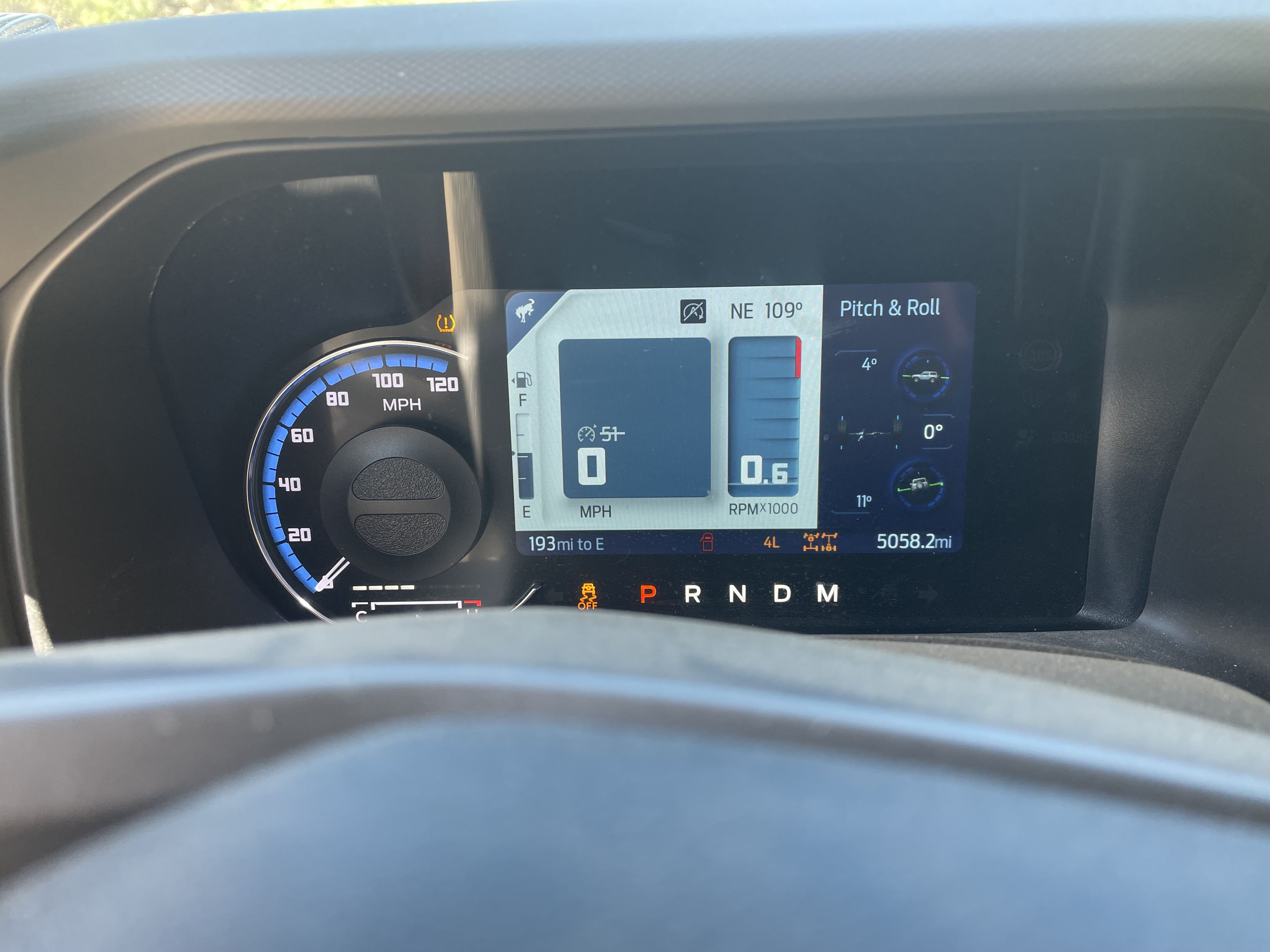

So I climbed down, spent WAY too long reconnecting the swaybar since I was out in the middle of a sandy wash lol, and got lined back up. And the results to me were honestly pretty surprising. So first I climbed as far as I could while keeping the rear tire on the ground, and in doing that I got a full 10'' less onto the obstacle before the tire started lifting:
And with that climb here were my cabin statistics:
So 2 degrees MORE body roll, with 10'' less up the obstacle. Pretty interesting how much less comfortable that 2 degrees make it, it definitely feels like a pretty significant difference. Now to do a full comparison, I also pushed the Bronco up all the way to where I was 32'' up the obstacle... and that result was pretty wild:
(Of note: The pitch was switching between 4 and 5 degrees so it must've been at like 4.99. Close enough)
So on the same obstacle with just a simple disconnect of the sway bar, you are experiencing a solid 4'' or so of additional travel at the rear wheel, but more importantly to me, you have almost 50% less body roll. With the cabin so much flatter it just feels more confident and sure-footed and the weight is more evenly distributed to avoid that "tippy" feeling. That is a seriously impressive improvement to me and makes the modification 100% worth it over *any* other suspension modification in my book.

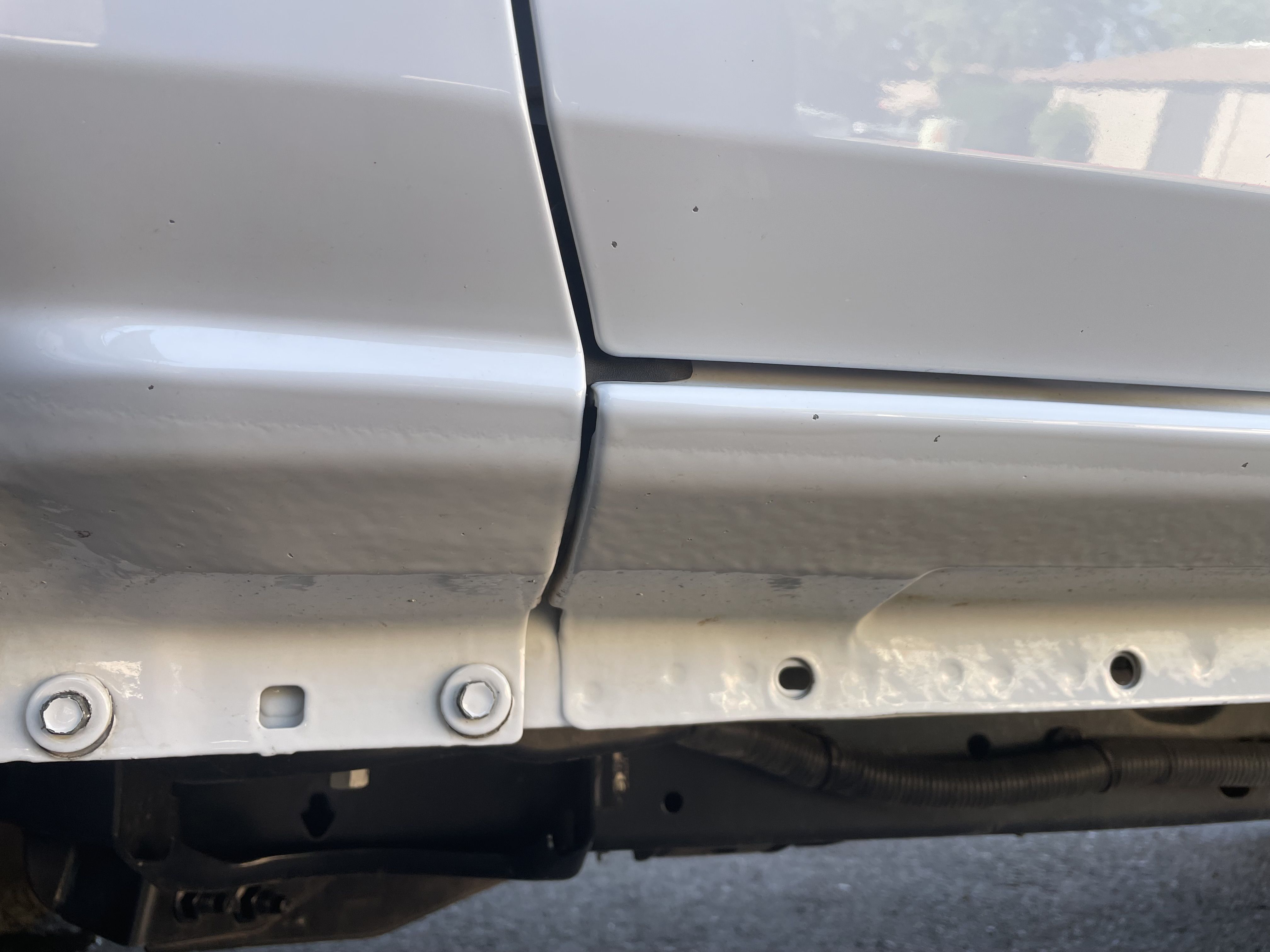

3. Mudflaps
I'm a hypocrite with this one. I have them ordered but have not received them yet. And I seriously regret not buying them sooner... but that's pretty self-explanatory
These paint chips are BRUTAL. Literally makes me want to cry. Learn from me!

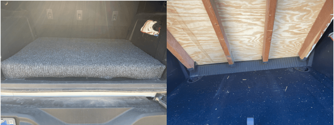

4. And lastly, a sleeping platform
I'm no carpenter, but with about$40 $400 worth of wood and outdoor carpet from lowe's, you can give yourself a flat load floor! The Bronco is super comfortable to sleep in like this, I threw in a cheap foam mattress pad and sleep like a baby. All you need is a sheet of plywood and some 2x4's. It is almost the exact height you need without any additional spacers or anything like that! You want to have some overhang on the back to allow the little transition some room. But this works great!
